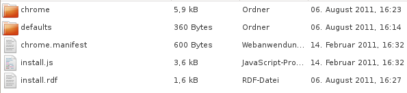

    [attachment=0]popupdown.png[/attachment]
    It immediately closes the pop-up/pop-unders popping out while you surf.
