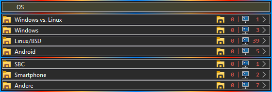

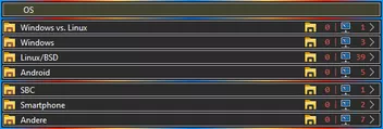

  • Nur die Anzeige der Ordner/Lesezeichenanzahl in einer anderen Farbe darstellen
    • Dharkness
    • 16. Juli 2023 um 18:01
    Zitat von Horstmann
    Code dazu, zack-zack! ;)
    Aber bitte doch.
    // BookmarkCount.uc.js
    /* Author BrokenHeart               => https://www.camp-firefox.de/forum/thema/136572/?postID=1229536#post1229536 **** */
    /* Correction from BrokenHeart      => https://www.camp-firefox.de/forum/thema/136572/?postID=1229696#post1229696 **** */
    /* Extension from Sören Henschel    => https://www.camp-firefox.de/forum/thema/136572/?postID=1229555#post1229555 **** */
    /* Customized by Mira inspired by grisu2099     ********************************************************************** */
    /* Source                           => https://www.camp-firefox.de/forum/thema/136572/?postID=1229875#post1229883 **** */
    /* Customized by Mira inspired by Horstmann     ********************************************************************** */
    /* Source                           => https://www.camp-firefox.de/forum/thema/136572/?postID=1229993#post1229993 **** */
    /* Version 1.01                     => https://www.camp-firefox.de/forum/thema/136572/?postID=1230128#post1230128 **** */
    /* Version 1.02                     => https://www.camp-firefox.de/forum/thema/136572/?postID=1230334#post1230334 **** */
    /* Custom Counter in the Bookmarks for folders and links ************************************************************* */
    /* rechtsbündig ****************************************************************************************************** */
        if (!window.gBrowser) return;
        setTimeout(function() {
            setFunction();
        },50);
        let profilePath = PathUtils.toFileURI(PathUtils.join(PathUtils.profileDir, 'chrome', 'icons'))
        let icon1 = "folder-4s.png"
        let icon2 = "Bildschirm-3.png"
        function setFunction() {
            const css =`
                .countClass1::before {
                    content: "";
                    background-image: url(${profilePath}/${icon1});     /*  Custom icon  */
                    background-repeat: no-repeat;
                    background-size: 16px;                              /* icon size */
                    background-position: center;
                    margin-left: 16px !important;                       /* Abstand links minimum für schmale Popus  CHANGE  */
                    margin-right: 2px !important;                      /* Abstand Icon "Ordner" bis zum "Zähler" */
                    height: 16px;
                    width: 16px;
                    fill: #c0c0c0;
                    fill-opacity: 1;
                /* Default FX left margin ist 16px !! -->  CHANGE  */
                .countClass1 label {
                    margin-inline: 0px !important;
                /* Ordner container Inhalt zentriert -->  CHANGE  */
                hbox.menu-accel-container.countClass1 {
                    align-items: center !important;
                .countClass1::after {
                    content: attr(data-value1) !important;
                    font-family:  Consolas, "Lucida Console", "Courier New", monospace !important;
                    font-size: 12px !important;
                    font-weight: 900 !important;
                    color: #D2534C !important;                        /* Farbe des 1. Textes */
                    height: 14px;                                       /* height = font size Text zentriert CHANGE  */
                    width: 15px !important;                             /* Platzhalter für Anzahl der Stellen */
                    padding-left: 4px !important;                       /* height = font size Text zentriert CHANGE  */
                    margin-right: 0px !important;                       /* Abstand zum Icon "Links" rechts */
                    /* background-color: lightblue; */                /*  TEST  */
                .countClass2::before {
                    content: "|";
                    background-image: url(${profilePath}/${icon2});     /*  Custom icon  */
                    padding-right: 16px;
                    padding-bottom: 4px;
                    margin-left: 6px !important;                        /* Abstand "Zähler 1" zum Icon2 */
                    margin-right: -12px !important;                      /* Abstand Icon "Links" bis zum "Zähler" */
                    height: 16px;
                    width: 16px;
                    fill: #c0c0c0;
                    fill-opacity: 1;
                .countClass2::after {
                    content: attr(data-value2);
                    color: #D2534C !important;                        /* Farbe des 2. Textes */
                    width: 15px !important;                             /* Platzhalter für Anzahl der Stellen (25px für 3 Stellen) */
                    margin-right: 8px !important;                       /* Abstand zum Pfeil recht */
                .countClass2 image {
                    order: 1;                                           /* Pfeil ganz nach rechts */
            const sss = Cc['@mozilla.org/content/style-sheet-service;1'].getService(Ci.nsIStyleSheetService);
            const uri = Services.io.newURI('data:text/css,' + encodeURIComponent(css));
            let bmbMenu = document.getElementById('bookmarks-menu-button');
            let bookMenu = document.getElementById('bookmarksMenu');
            let persToolBar = document.getElementById('PersonalToolbar');
            if(bmbMenu)
                bmbMenu.addEventListener('popupshowing', onPopupShowing );
            if(bookMenu)
                bookMenu.addEventListener('popupshowing', onPopupShowing );
            if(persToolBar)
                persToolBar.addEventListener('popupshowing', onPopupShowing );
        function onPopupShowing(aEvent) {
            let popup = aEvent.originalTarget;
            for (let item of popup.children) {
                if (item.localName != 'menu' || item.id?.startsWith('history')) {
                    continue;
                setTimeout(() => {
                  let itemPopup = item.menupopup;
                  itemPopup.hidden = true;
                  itemPopup.collapsed = true;
                  itemPopup.openPopup();
                  itemPopup.hidePopup();
                  let menuitemCount = 0;
                  let menuCount = 0;
                  for (let subitem of itemPopup.children) {
                    if (subitem.classList.contains('bookmark-item') && !subitem.disabled && !subitem.hidden) {
                      if (subitem.localName == 'menuitem') {
                        menuitemCount++;
                      } else if (subitem.localName == 'menu') {
                        menuCount++;
                  itemPopup.hidden = false;
                  itemPopup.collapsed = false;
                  item.style.color = '#c0c0c0';
                  let label1 = item.childNodes[3];
                  label1.classList.add('countClass1');
                  let strCountOut1 = String(menuCount).padStart(2, '\xa0');
                  label1.setAttribute('data-value1', strCountOut1);
                  let label2 = item.childNodes[4];
                  label2.classList.add('countClass2');
                  let strCountOut2 = String(menuitemCount).padStart(3, '\xa0');
                  label2.setAttribute('data-value2', strCountOut2);
                }, 100);
    • Dharkness
    • 15. Juli 2023 um 23:26
    Zitat von Horstmann
    Aber wieso, die Zahlen rechtsbündig geht doch genauso gut mit den Zahlen nach den Icons?
    Und wie, wenn man das ↓ als Basis nimmt?
    • Dharkness
    • 15. Juli 2023 um 16:58
    Zitat von grisu2099
    Wenn du damit leben kannst, daß die Icons vor den Icons sind, kannst du ja mal diese Version testen:
    Wenn Du mir erzählst, wie man den Schrägstrich zwischen Ordner und Bookmarks entfernt, könnte ich möglicherweise damit zurechtkommen.
