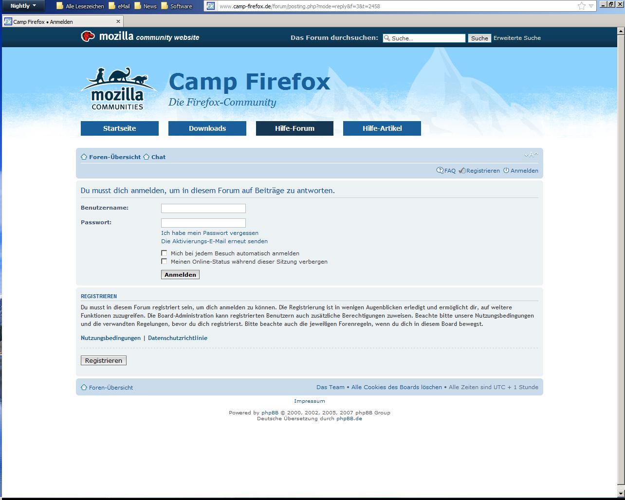

    • hoschen
    • 4. November 2011 um 14:00
    Firefox Nightly
      • 134,49 kB
      • 1.284 × 1.028
